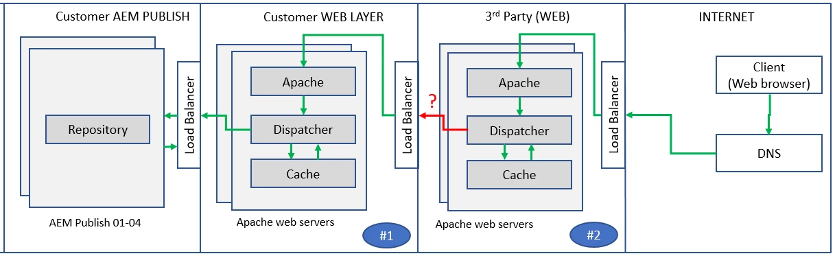

Hello Guys, Need your suggestions on a Apache/Dispatcher setup. (Please see the attached diagram)
Scenario
The customer has the standard AEM Publish and Apache web servers (shown as #1 in the diagram) already setup and there are multiple websites hosted here.
For one new site, there is a need to access the site through a new set of web servers (shown as #2 in the diagram) hosted on a 3rd party cloud.
If you look closely, this is a different-than-regular scenario with 2 web servers in the request path. Usually we have just one web layer load balancing AEM publish instances.
I am able to access the website via LB 1's URL origin-some-domain.com. LB has a valid certificate installed on it. LB accepts requests directly on port 443 and forces all requests to HTTP port 80 requests to port 443.
Problem
Next, I want to hook dispatcher #2 to this LB 1. There is no blocking firewall between 3rd party web servers and the LB.
Both the web servers #2 and Apache #2 do NOT have SSL enabled. I am not sure if SSL is needed on Apache #2 or Dispatcher #2 or both to communicate with LB 1. Please suggest if that is needed and guidelines around how to do it?

Why there are two layers of dispatcher?
Can't you point the DNS directly to the #1 load balancer?
The dispatcher cant point to another load balancer or dispatcher, based on your scenario the Apache ProxyPass configurations(Reverse Proxy Configuration) can be used in #2 Apache server to send the request for specific URL's to #1 load balancer URL
Read more about Apache ProxyPass here - https://httpd.apache.org/docs/2.4/howto/reverse_proxy.html

leoberliantAdobe EmployeeAccepted solution
July 22, 2020
I agree with albinissac
Two subsequent dispatchers are not a proper configuration. If you have multiple sites that need to be accessed as different sites you can use a single Apache.
Please review KB at https://docs.adobe.com/content/help/en/experience-manager-dispatcher/using/configuring/dispatcher-domains.html, it describes that scenario in details

You are absolutely correct! This does not look ideal, however there are multiple factors that lead us to this setup. There are few more options on the table that we are considering, however, I wanted to explore this option before we simply drop it.
I have been able to connect 2 dispatchers in a row and the traffic flows as expected #2 > #1 > Publishers and back. So, that is solved and I have tested it. It works over HTTP.
Dispatcher #2 > LB (HTTP) > Dispatcher #1 > Publishers
What I am not sure about, and need help to understand, is how to connect dispatcher #2 to a LB over HTTPS? I am willing to try options to make this work.

Two subsequent dispatchers are not even a supported topology. You should not consider this scenario.
