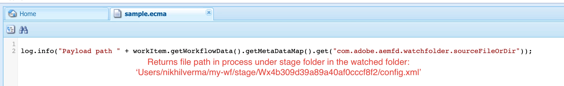

But the above could be an overkill for light weight use cases, and just extracting the file name with a little custom code would be a faster way. You can extract file name of the input file using ECMA script in AEM workflow:
And then refer this script in the 'Process Step'.
