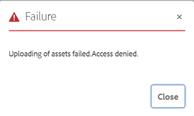

I am facing an issue where the user is not able to upload an XDP file into /content/dam/formsanddocuments after logging in.
We have SSO integrated with AEM 6.5.21 author, and the users are automatically created and added to content-author group. We have also additionally provided all the permission for /content/dam.
But when the user tries to upload an XDP file, then we see this error.

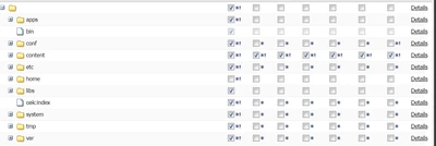

The user has the following permission.
Kindly let me know if I am missing out something. Thank you.
