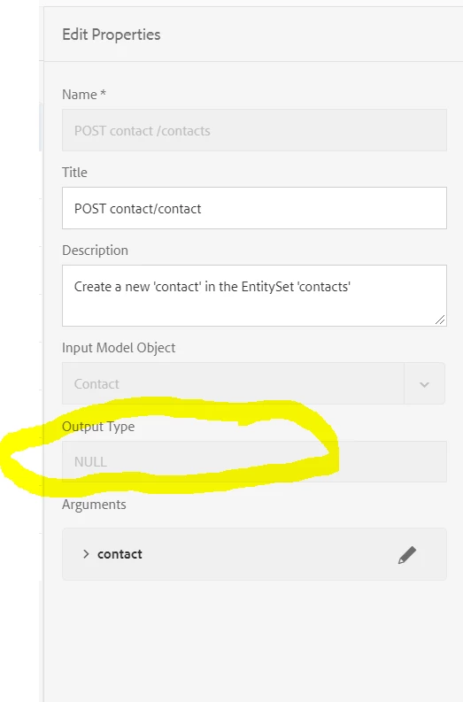

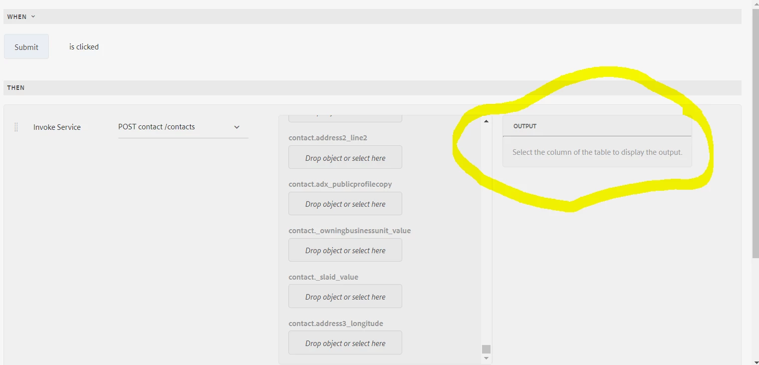

What else I tried: Submitting through "Invoke service"(My idea was for invoke service to return an id of newly submitted entry  and assign it to a hidden field then make another call to submit to the Associated Entity using that Id). But that didn't work out well as per the following screenshot. 🙄
 I went confidently to my Service to configure the return type but that was grayed out🙄
 So please help me out. Is it possible to enable the grayed out area? If so, Please explain how I can do that or maybe provide a link where someone does the same. If not, please help me with ideas of how I can get around my dilemma or a link where someone explains this.

@5243938- Output Type of service can't be changed from FDM (Form Data Model). You need to implement following workflow
  1. Create custom action/service in dynamics which store contact and return Id.
  2. Include custom action in FDM and use it instead of default POST contact/contact then remaining follow should work
