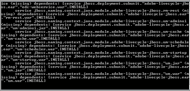

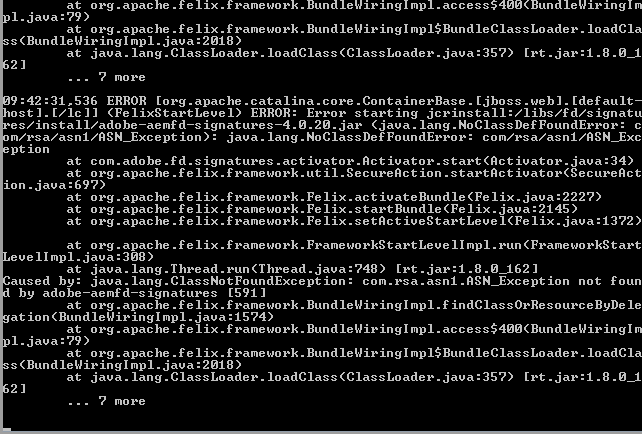

February 14, 2018
Good morning
Ok, so tried doing what you mentioned in last thread, did that to the first instance, and it broke it, to the point i had to re-install, couldn't restart it afterwards properly.
Tried it on second instance (where i i have a copy of the jboss folder) and that didn't work either.
Guys, thank you so much for your help thus far.
Again i yet to have this working, the documentation says its doable, the community says its doable, but yet, nothing i try gets that second instance working.
We paid so much money for this, and to get a software that is so difficult to run on first try, is new to me.... So now, i have first instance running again, could i get an actual step-by-step of what is exactly needed for that second instance to run???
I'M RUNNING AEM 6.3, JBoss 6.4 i believe on windows server. I'm using the "aemforms_server_6_3_0_jboss_all_win.zip" for the .exe file. and following the info in this PDF: "Installing and Deploying AEM forms on JEE Using JBoss Turnkey".
You test this out and let me know via private email if you prefer, just let me know if someone is going to look into this.
Thank you very much again,
Maruan_Sahyoun
February 14, 2018
Are you running
standalone.bat -Djboss.socket.binding.port-offset=110
from the command prompt? If yes, there should be a console output as well as log output in <jboss 2nd install>/standalone(log/server.log.
That works just fine. Now to an important topic. You wrote that you copied the installed/running version. Don't do this!
You need to do a fresh install on the second JBoss instance as otherwise the Database, Temp directory ... is shared which will cause you issues at least remove the adobe*.ear/war files from the deployment directory before starting the second instance of JBoss.
