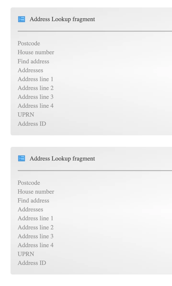

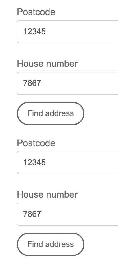

We have an address fragment that we have pulled in twice to a form (address and work address) When we enter the postcode in the 1st instance the postcode field the second instance field renders the same value. We have tried this with and without a schema for the form. Where we have used a schema we have bound each fragment to the specific part of the data model.
When it rendered and you enter data its it repeated in the field for the other fragment
The generated input fields have different id and name attributes.
Does anyone know if there is a mechanism to address this?

This is expected as fields from two fragment instances will have the same bindings and, thus, the same data based on the value from the DOM. Basically, if you create a section that is repeating, then the field names will be the same, and there will be multiple instances of the same field. The repeating section will create multiple copies of the inner elements (fields), and all will have the same name, but the index will be different.
A better approach is to build one fragment for the same section that will repeat multiple times instead of creating the same section/field multiple times in design time.

@iainclucas There are two way why the data will be replicated.
1. The name of the object is the same
2. The binding of the two is the same.
while the 2 can be used in the specific case where the actual need is to have the same value in another field.
Solution- all you have to do is check the binding field and change it so that it's different.
