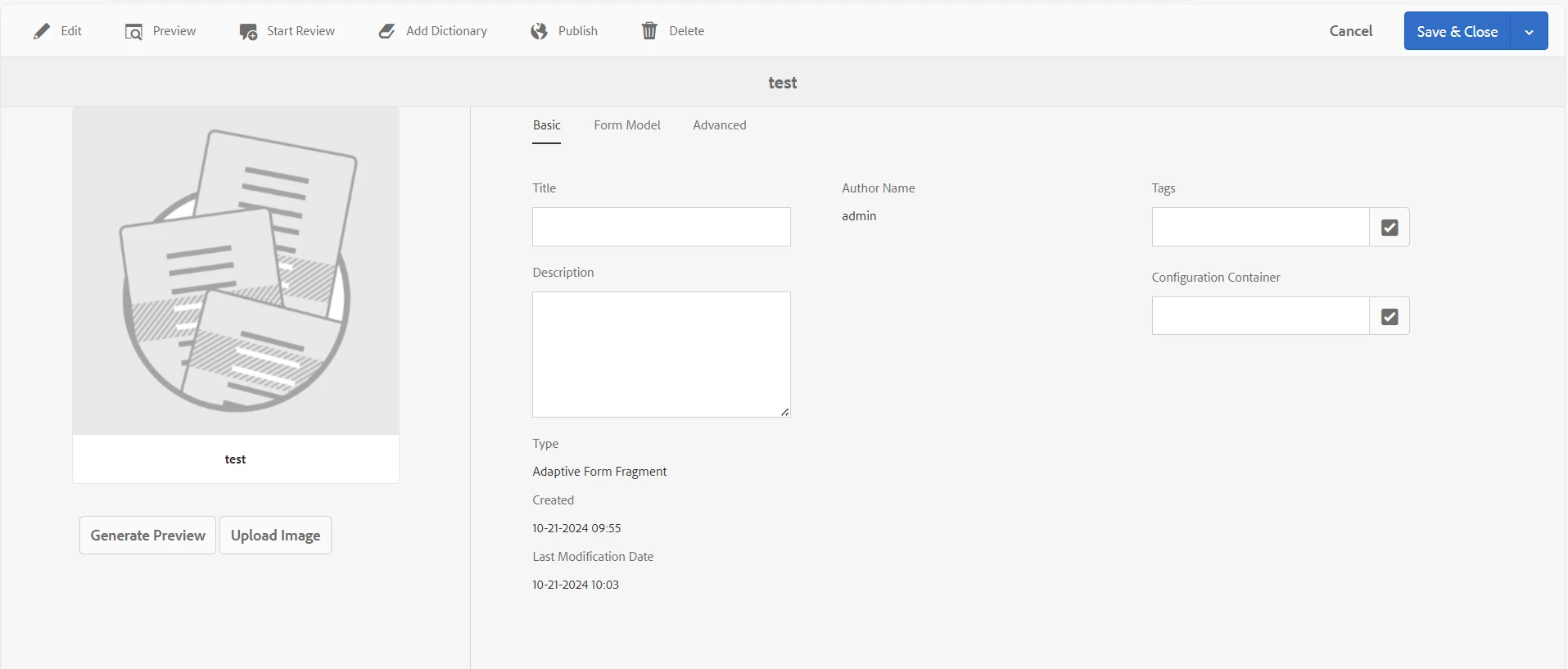

I want to do some modifications to some properties on Adaptive Form and Adaptive Form Fragment (AF from now on). Right now, if I open the properties of an AF I'll see something like this:
The values I want to change are for: Author Name and Created/Last Modifiy/Last Published.

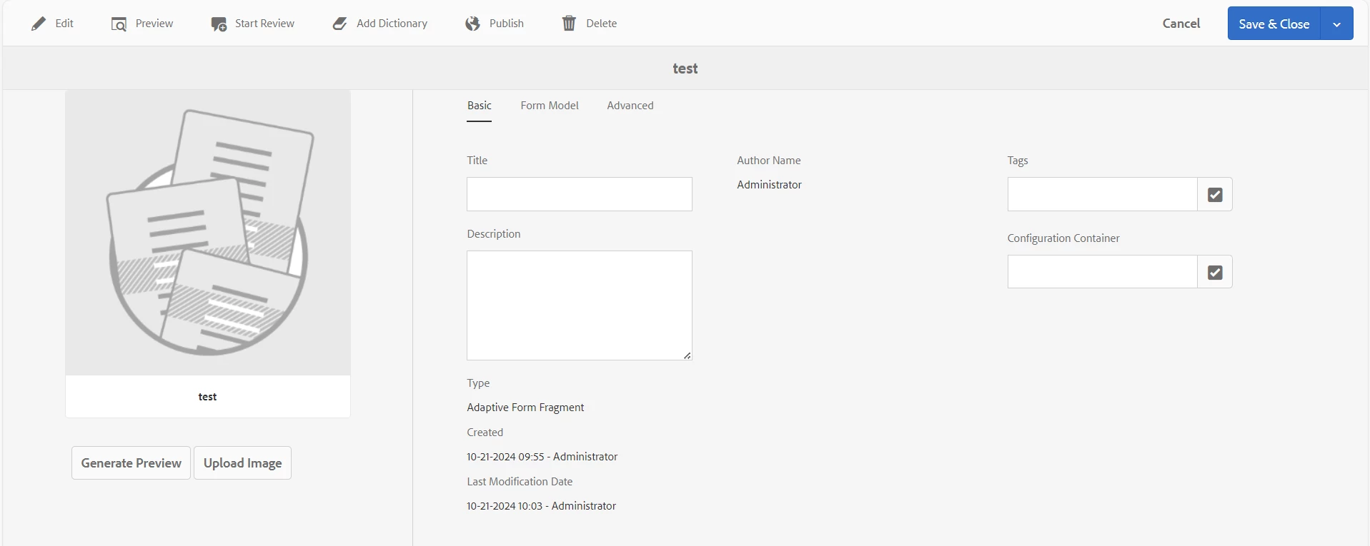

For Author Name I want display the UserName instead of the UserID and for the Dates I want to show it like it is right now but also add the User Name to know who created the AF, who modified last and the same for the publish.
Something like this.
