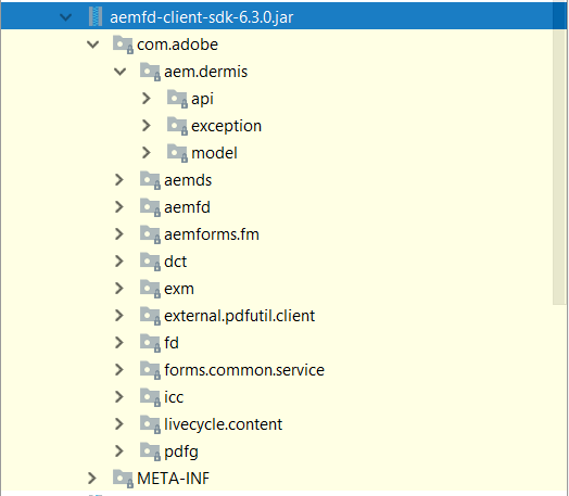

Hi Darren, I checked aemfd-client-sdk-6.3 jar, It does not seem to include the package com.adobe.aem.dermis.odata
The actual dermis odata package does not exist in the client SDK package, but should provide a way to invoke it via the exposed API.
If you want the actual dermis package(s) they are located in the forms installer zip (e.g. AEM-FORMS-6.4-OSX-5.0.86.zip / adobe-aemds-common-pkg-5.0.86.zip / aem-dermis-content-2.0.54.zip)
I am looking for the service com.adobe.aem.dermis.odata.service.ODataConnector#executeRequest(), will have to see if this can be achieved by exposed classes in sdk.
this class is exported by aem-dermis-odata-connector-2.0.54.jar. I am trying to avid the need to install the jar manually in maven repo as it would unnecessarily complicate the dev setup.
