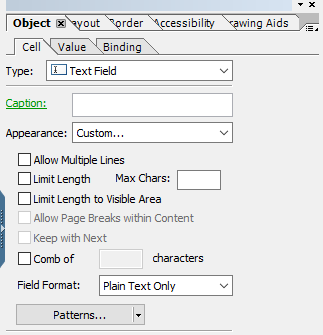

1. For aligning fields and grouping the items you can use the table option.
In this case, the table holds label and value separately,
for the value field at row2
without a caption and select the custom options.
This one is a corner case, so i don't think there is an option to allow line breaks within the field caption while you do have an option if it's a rich text field, you can use an html <br> tag.
Ideally, you should rework on the layout to ensure that the UI suits the requirement.
For the second question, If you have set the message box alert on the initialize event of the next field (after the ones above) then you may set the focus on the "Percentage Total" field of the form at the exit or any button click event of the message box or this thread elaborates a similar use-case.

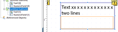

Hi @fogharty ,
the labels will not break lines and \n or <br> will also not work.
In this case simply design your field without caption (turn it off in Layout) and place a Text object right above it.
Captions are static as well. With this approach you even could use floating fields if needed.
Design the Text object with Paragraph Bottom so that the text is aligned with the top of your field. But you could also tweak it by changing height and move it.
To get the line borders around it in the same way I arranged them in a subform (make it float Top to Bottom for easier positioning) and set the border of the subform.
result:
See if that approach works for you.
Hi @fogharty ,
