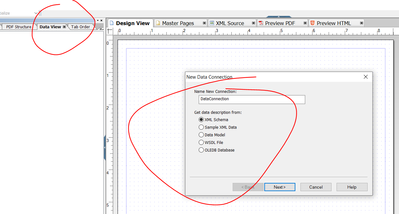

3. Use the XSD from (2) in the designer and bind the XDP to the schema elements using data view tab.
