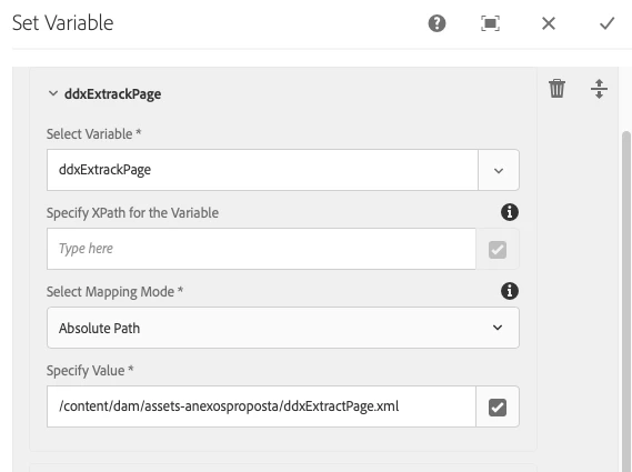

  1. Create one file with DDX commands.
<DDX xmlns="http://ns.adobe.com/DDX/1.0/"> <PDF result = "doc.pdf"> <PDF source = "docLoteDeclaracoes" pages="1"/> </PDF> <?ddx-source-hint name = "docLoteDeclaracoes"?> </DDX>
  1. Set one process variable type XML with file content.

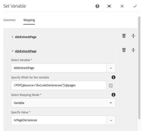

  1. Update command XML Node with xpath for the content.
XPath: //PDF[@source="docLoteDeclaracoes"]/@pages

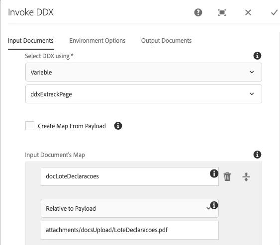

  1. Invoke DDX

Thanks @workflowuser. I already solved this putting DDX script into a XML variable and alter properties with a set Variables Step with a Xpath expression (//PDF[@source="docLoteDeclaracoes"]/@pages) to update required property. But I will test your Process Step bundle too.

This is other solution for this case.
  1. Invoke DDX
