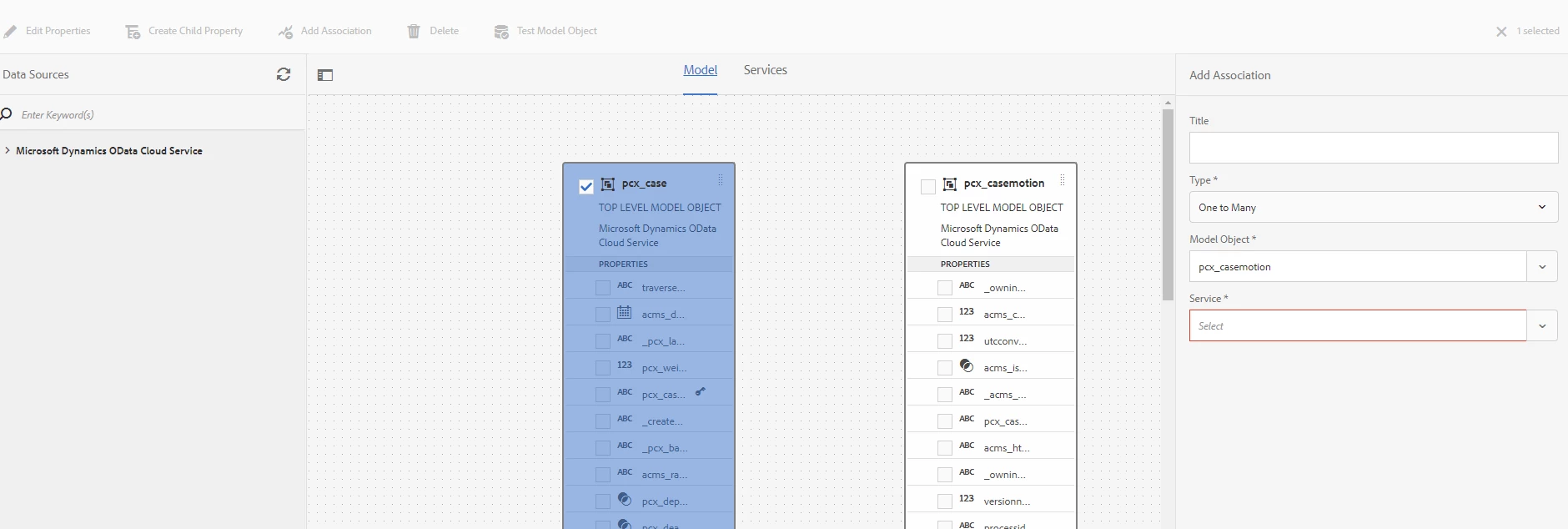

I have a pcx_case table an a pcx_casemotion table. how do I add a one to many association? are
is this what I need? if so how do I use it

select the service which returns the results for you

go to the 2 minute mark in the video. it talks about creating associations between two entities
workflowuser I did and the video does not say anything about that services drop down menu that appeared.
You can refer "add associations" section under Adobe Experience Manager Help | AEM Forms Data Integration

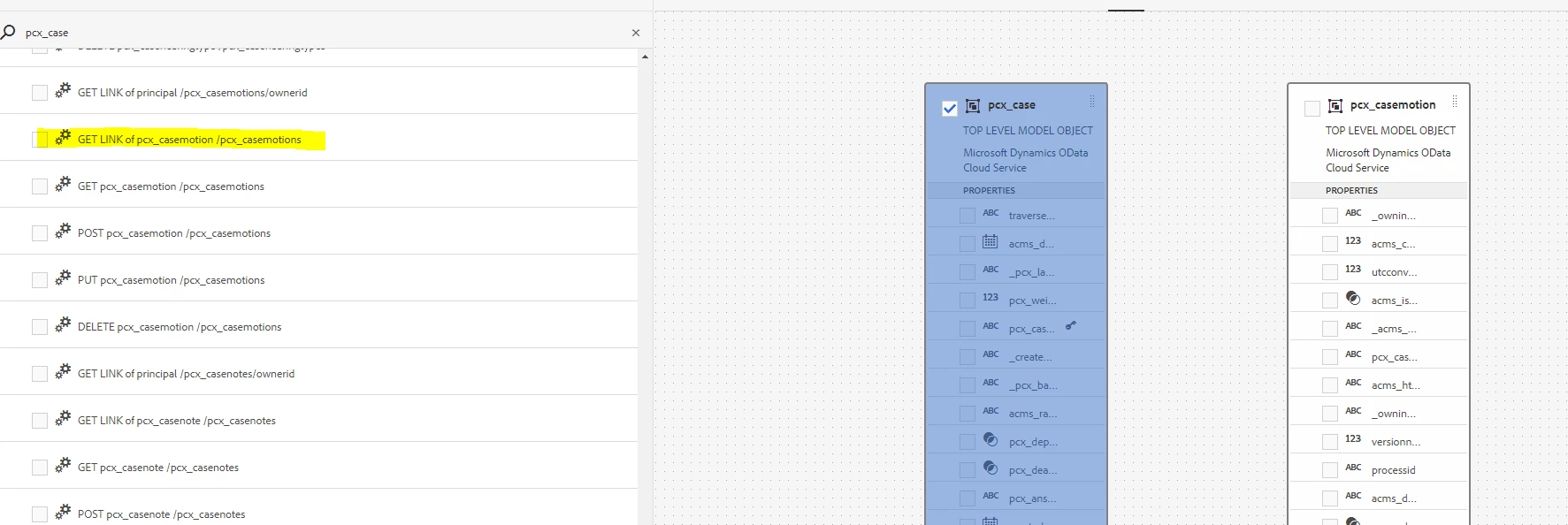

workflowuser, Mayank Gandhi thank you both. you both gave me the right answer but workflower hit it in the right spot
here is my association so that it can help future people
