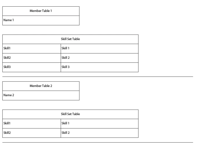

Hi, I'm new to livecycle designer.
We have a requirement of displaying multiple tables from the xml values.
<member_table num=1>
     <name>
    <skills>
        <SKILL1>
        <SKILL2>
        <SKILL3>
   </skills>
</member_table>
<member_table num=2>
     <name>
     <skills>
        <SKILL1>
        <SKILL2>
   </skills>
</member_table>
For each member number,
1. I should display member table which has one row with name
2. I should display skill table with all skills listed (this differs from member to member)
Approach :
Built member table and skill table in a subform, and used action builder to repeat the subform for every member. I am able to get member table correctly as it has only one row. But skill table is getting with only one row, and first value is getting filled.
Please help on how to retrieve all the skills into all the skills tables based on member number.
Best answer by Kosta_Prokopiu1
OK, here we go: https://documentcloud.adobe.com/link/track?uri=urn:aaid:scds:US:0b9769f5-5a7c-489f-99fa-9de489d4a89b
The structure of the data is vital for success here. See if you can adapt your data accordingly. Check also the Binding tab under Object.
I hope that helps - it is only a quick sample - you may have to adapt to your data and real form....

You have created a hierarchical data structure and want to consume the data in more than one dynamic subform/table construct. That does not work because the data is gone through once (your member table) and then there is no "Reset" so your skills table are out of data. For that to work you could restructure your XML data like so:
<root>
    <member_table>
        <member>
            <number>1</number>
            <name>Name 1</name>
        </member>
        <member>
            <number>2</number>
            <name>Name 2</name>
        </member>
    </member_table>
    <skills_tables>
        <skill_table>
            <number>1</number>
            <name>if required in the skill table</name>
            <skills>
                <skill1>Skill 1</skill1>
                <skill2>Skill 2</skill2>
                <skill3>Skill 3</skill3>
            </skills>
        </skill_table>
        <skill_table>
            <number>2</number>
            <skills>
            </skills>
        </skill_table>
    </skills_tables>
</root>
Kosta_Prokopiu1
December 16, 2020
I just realizeed - loose the numbers in the skill tags. <skill> instead of <skill1> etc - then you are truely dynamic
