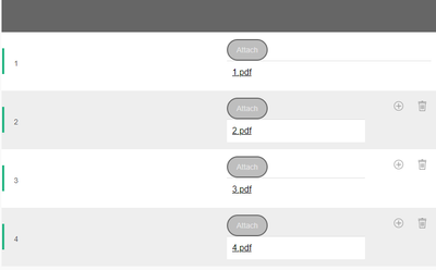

The following is the dynamic table with file attachments. The ordering is PDFs 1,2,3,4, but the resultant PDF from the process gives ordering 2,3,4,1.

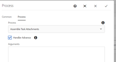

Deploy and start the custom bundle and do the following. in your workflow drop process step component.( this will replace the invoke DDX step) associate the process with Assemble Task Attachments. this code assembles the  PDF  attachments of the Adaptive Form and stores it in a file called assembled-pdf.pdf under the payload folder. Create a variable called assembledPDF of type Document. Use the Set Variable component to initialize the variable as shown in the screen shot . You can use this variable in your send email step

Hi workflowuser, I tested your process locally and it works great. Is it possible to reorder the attachments? I currently have a dynamic table where each row has an attach file button. The first row is static and the following rows can be added dynamically. In the resultant PDF from the process, the ordering of the attachments prioritizes the dynamic rows over the first static row, when it should be the first row then the dynamic rows. I will add a screenshot to my original post to explain better.

In the process step we can specify the order in which you want the attachments to be assembled.In this screenshot attachment added to the field called idcard will be the first pdf followed by attachments added to the bankstatements which is a field in a table that can grow
