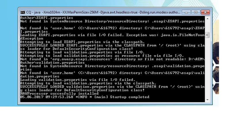

I started the AEM author instance by the start.bat ( crx-quickstart > bin > start.bat ), there the server is showing the startup complete but when i am hitting on link localhost:4502 it is showing connection refused ??

Are you able to open crxde[http://localhost:4502/crx/de/index.jsp ] or explorer or system console[http://localhost:4502/system/console/configMgr ].
Also, can you check for anything suspicious in error/startup log file.
Sh1ju
June 5, 2017
Are you able to view bundles from felix console  http://localhost:4502/system/console/bundles  ? Any issues from  Error.log ?
June 5, 2017
I am not even able to hit the login page of AEM, and i am not able to find anything suspicious in error.log,
Later i realized that i am able to work in explorer but not in chrome so i got ip of my system and from that i accessed AEM
(<ip address>:4502) but not when i hit localhost:4502, Why so?

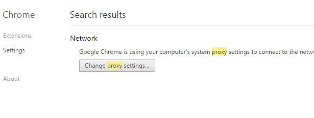

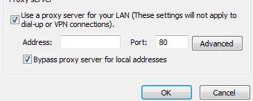

In your office network if you are using a proxy network, this issue can happen in chrome . We have faced this issue due to the proxy settings in chrome browser. Could you check the below
If you are using Chrome. Can you go to settings --> Change proxy settings --> if the bypass proxy is unchecked , please check it....
Since I dont have proxy settings, below image is only for demonstration
Let me know if this worked

Thanks @shiju for the concern but changing proxy settings worked for me, as i am working office network so no admin rights is there
