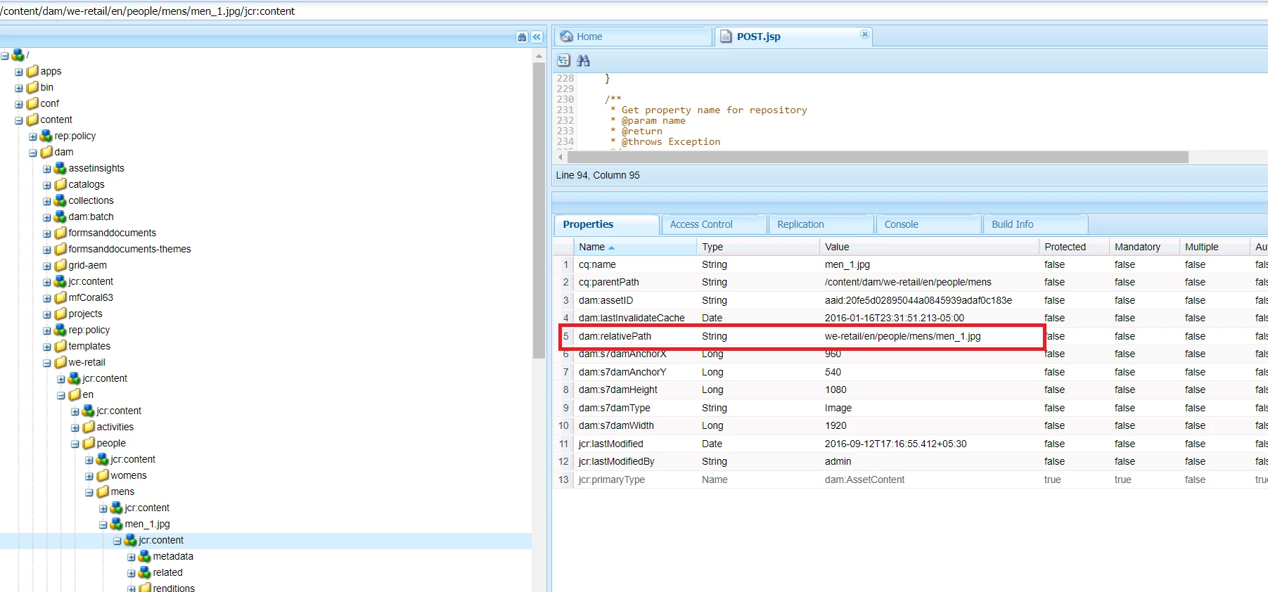

This prop tracks the location of the Asset. Consider this asset:

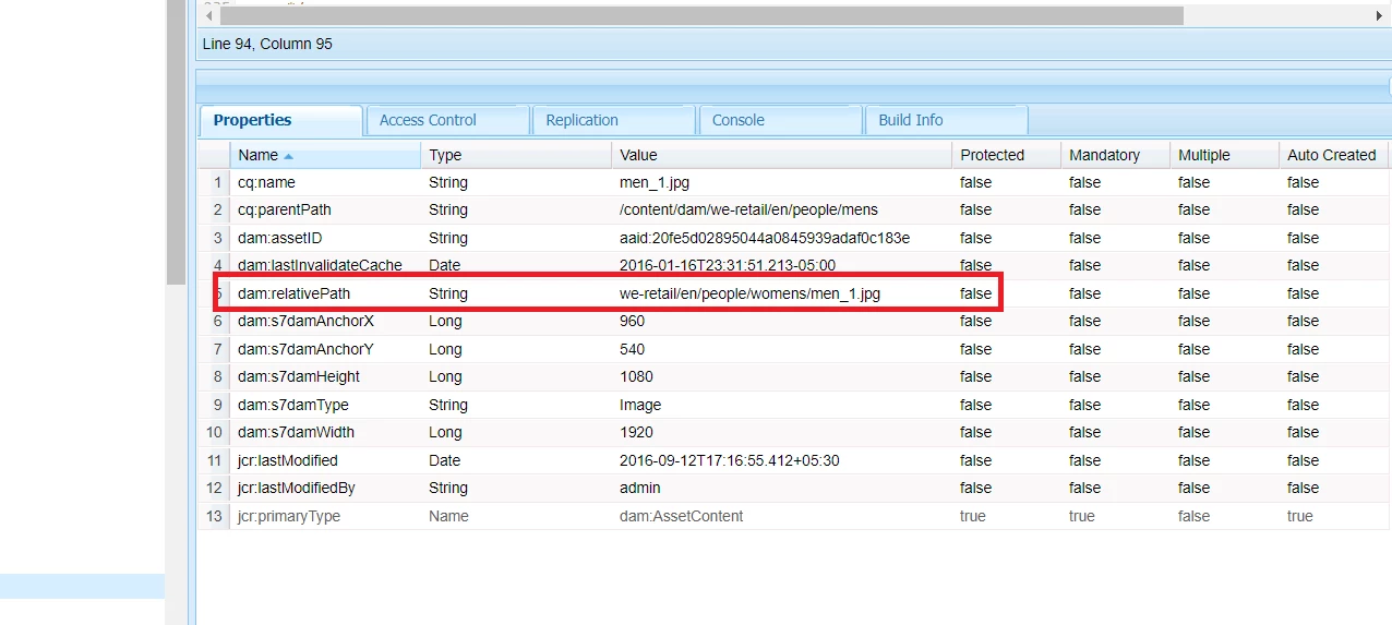

I moved this asset to this location: /content/dam/we-retail/en/people/womens
Now notice that this value reflects the new path:
smacdonald2008
December 7, 2017
As you saw - this prop is updated when you move the asset to another location.
