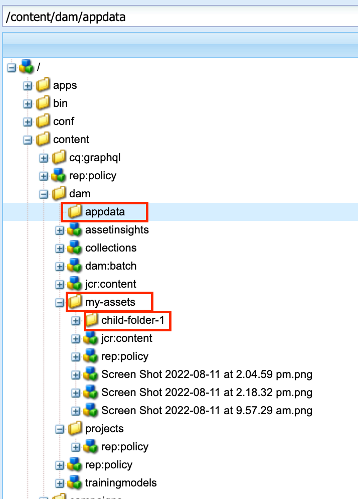

I think for what you're after, you need query builder instead of Assets API.
Try this: http://localhost:4502/bin/querybuilder.json?path=/content/dam&1_property=jcr:primaryType&1_property....
You should get a JSON output with a list of all folders inside DAM:
Folder structure in DAM:

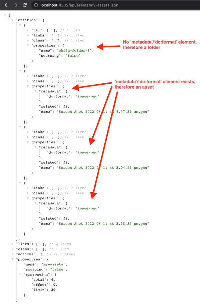

I have the below folder structure in my AEM Assets containing a parent folder ('my-assets') which again contains 3 assets and 1 folder:
The Assets API on 'my-assets' folder returns below:
It is clear I see that for assets the 'properties' element has 'metadata' and dc:format' elements.
Whereas, for folders these elements don't exist.
Which makes sense, as dc:format and metadata nodes in CRX exists for assets and not folders.
So you can know whether it is a folder or an asset.
