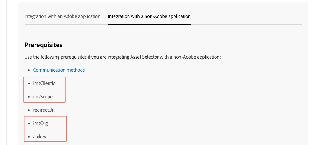

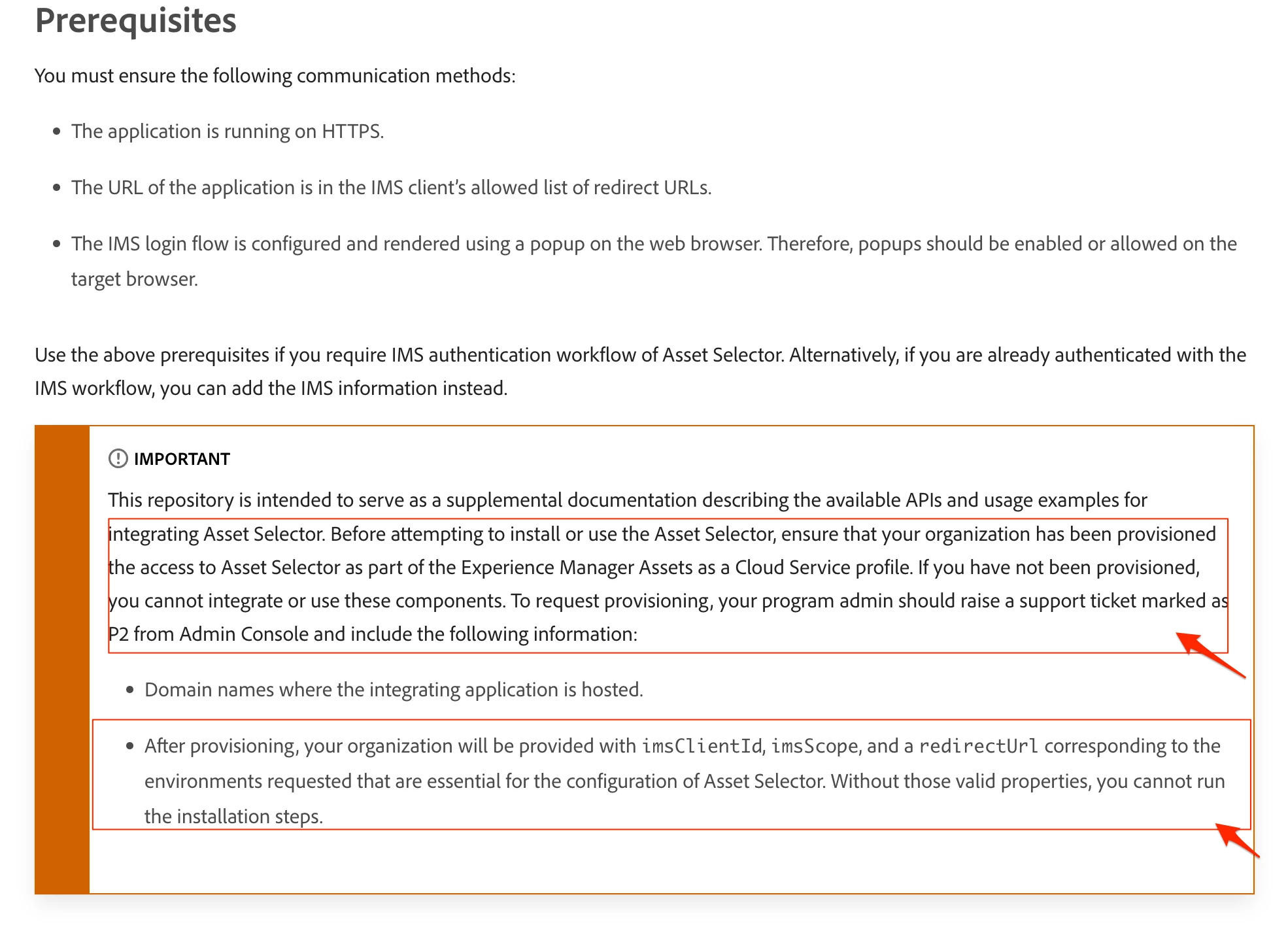

Hey @JanaMi1
If you are asking whether you can test or use the 'Asset Selector' without IMS, the answer is NO. IMS is the authentication method for your AEM instance. That's why the 'Asset Selector' is a service that must be enabled on your IMS account. Only then can you obtain the required parameters to initialize the Asset Selector. I believe this note is what you are looking for:
Hope this helps

The asset selector connects with your AEMaaCS instance through IMS (Adobe Identity Management System). So, you need to establish the connection between your application (asset selector) and IMS. Therefore, what you need are the credentials from IMS. If your client can set up this configuration and share this information with you, you should be good to go for local development.
Hope this helps.
Esteban Bustamante
