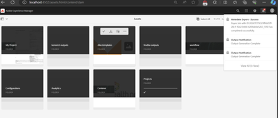

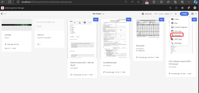

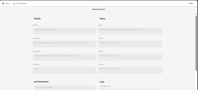

Hi smrithi_govind You can also use OOTB feature, you can export metadata then do necessary changes in CSV file and  import updated CSV refer follow steps
Export metadata and download
Modify file and upload it again using below path.
in second approach you can write java servlet using JCR API you can remove properties Let me know if it helps you or not
