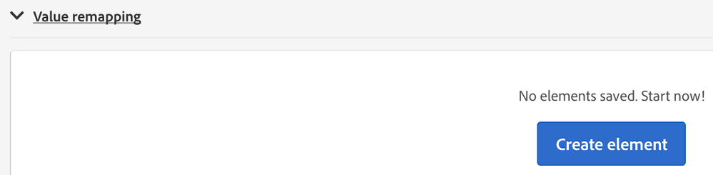

Screenshot:
I add the values "Unites States > US" and "Canada > CA", save, run my import to success, and the Profile's country field is filled in. HOWEVER: If I upload a new file, Value remapping is blank again, and because location/@countryCode expects the ISO2 format, the Profile's country field will be blank. I have to re-add my Value remapping to get the country back.
