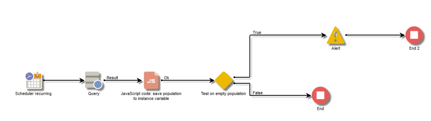

Best answer by Marcel_Szimonisz

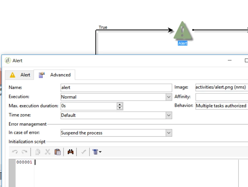

The error is okey
but make sure you are using the right instance variable and actually it is better to use alert activity instead of delivery.
The workflow can look like the one below:
where:
- query population you want report on
- java script activity where you save population from query to the instance variable
  • also you can write this code into the initialization script of the alert activity instead of having JS activity in the workflow
- test activity is checking population count > 0 in which case it will send alert message to any operator or group
- alert where you loop over the population and make e.g table from it, which will be send alert to operator
Marcel

Apologies to revive a thread that appears to be tied up, but I've followed this example of query > Javascript > Delivery and I get the same error in the Delivery that the instance is not defined. Are you able to assist with this at all?
The code in my JS element is:
var query = xtk.queryDef.create(
    <queryDef schema="temp:query" operation="select">
      <select>
       <node expr="event"/>
       <node expr="count"/>
      </select>
     </queryDef>
  instance.vars.items = query.ExecuteQuery();
  logInfo( instance.vars.items);

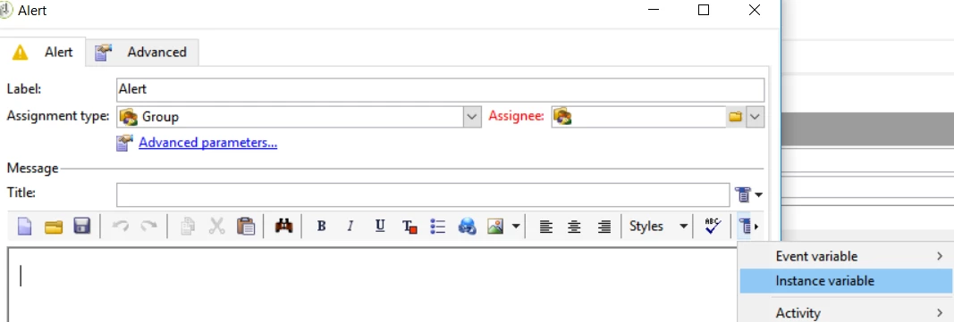

Amit_Kumar
February 5, 2018
Hi Andy,
what you are doing will not work in delivery activity.
Reason: An instance is an object of the workflow, so your instance variable or variable is only available in the workflow execution instance. These variable are not available to MTA(while preparing email delivery personalization) that's why you are getting this error.
Option 1 you can define a new variable at the delivery label and store this variable in the delivery variables.
option 2: use alert activity and you will be able to use your code as is
option 3: add this value as new personalization object in delivery visa delivery advanced properties.
Option 2 will be easy to implement.
Amit
