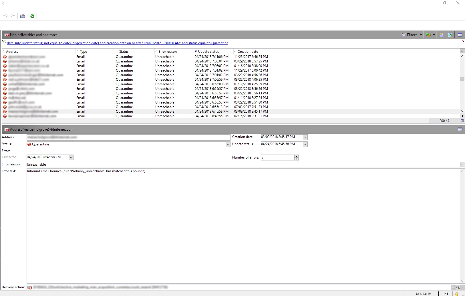

Hi There,
I was just inspecting the data in the nms:address table.
I know that records generated with a status of quarantine are added to this table as a result of an email address hard bouncing (or soft bouncing many times).
What I'm not sure about is the difference between Creation date and Update status columns.
I understand that the creation date is the first time the record is added to the table (e.g. the first time that email address hard bounced).
But what does the update status field indicate?
How is updated? How can it be different from creation date? (in my head I thought once a record bounced and it was added to the table, it gets excludes any recipient records with matching email addresses from future email deliveries - which it is doing - so therefore it cannot bounce again to modify the record in the nms:address table).
Any insight appreciated.
Below is a sample of records with difference update status dates vs creation dates.

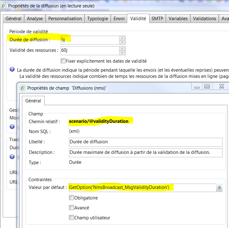

The LastModified column is changed for people moving from SoftBounce to either HardBounce (usually after 5 days except if you changed Delivery factory/default values) or Valid (until the nightly cleanup job deletes these lines), and also coming from the ESP (Gmail, Yahoo, etc) feedback look (see Documentation by searching for Feedback_loop, there are several articles) a few hours or day later.
What it is weird in your screenshot, is that update date is approximately one month later.
Might you check your deliveries value for validityDuration element?
I wonder if the validity of your deliveries could be 1 month, so every day it could be attempts to send and consecutive updates.
Please see below (in French UI):
Regards
J-Serge
Regards
J-Serge

Hi J-Serge Jean-Serge Biron​,
Yes, the large difference between the dates is what i was struggling to understand.
This is because we send all deliveries (unless time sensitive and then we may reduce) to have a validity length of 5 days.
Are you aware of anything else that may cause this? (it's not a feedback loop thing, I can see these ones)
