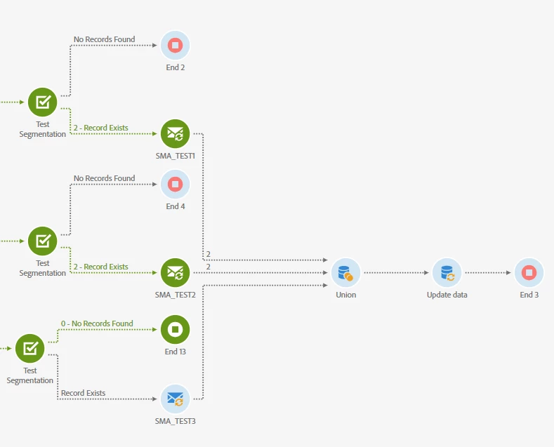

Hi! I'm using an Union activity after Email delivery to join all profiles who received an email, continuing with an update activity to update a resource.
The issue here is that, if Union activity doesn't receive records from all inbound transitions it won't execute (it's like it keeps waiting for records from the empty inbound transition). And in my case, there're many times where I don't send specific emails (SMA_TEST3) and I want to use the Union for the others which sent emails (SMA_TEST1 and SMA_TEST2)
Is there any configuration to handle that? I want to use Union even if there're inbound transitions with no records.

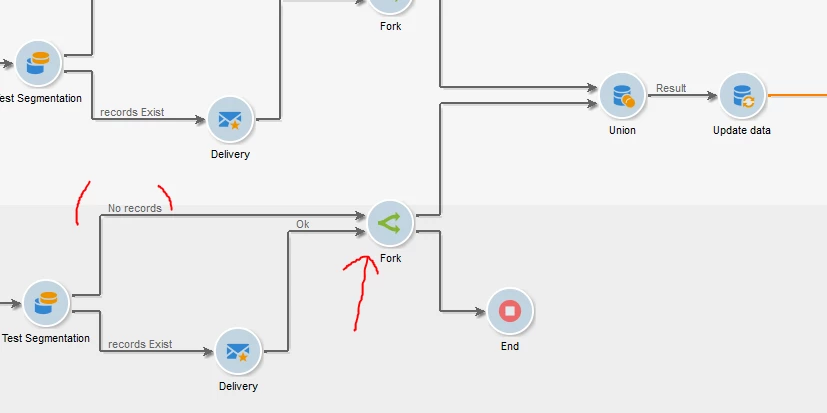

Hi @user06671 ,
Below screenshot is from Adobe campaign classic. But you can use the same activity and logic in Standard to achieve your logic.
After segmentation, Instead of connecting 'No records' transition to end activity, Connect it with 'Fork' activity. And connect its corresponding delivery activity's transition with the same fork. Now connect the fork transition to 'Union' Activity.
And repeat the same for your other flows (SMA_TEST1 and SMA_TEST2).
Now before Union, all its input transition will get activated with correct expected records. Give a try, and feel free to ask of you faced any issue.

Hi @user06671 ,

Great! But now I have another issue and it makes a lot of sense. In the "No records" transition there's no data so the union (based on "all shared columns") it's not possible as the "No records" transition has 0 records (so it has no columns)
