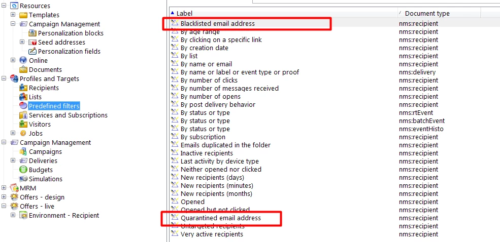

The predefined filters are already available for this and you can select the filter "Blacklisted email address" and"Quarantined email address" and add this to typology rule . Navigate to  Profiles and Targets\Predefined filters to see these filters

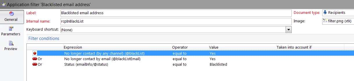

the condition to check blacklist is No longer contact (by any channel) (@blackList) from recipient table
