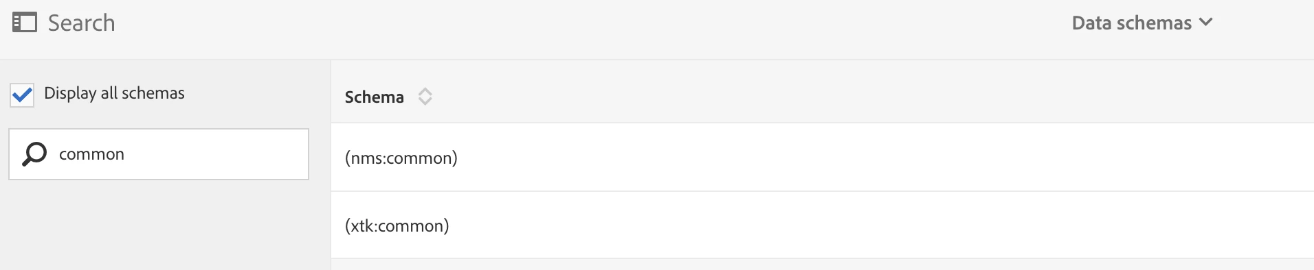

@karacatopbas, It should work if you use the appropriate language value sent from Azure as defined in the ACS. You can look at all possible language codes from the below location.
Make sure you select "Display all schemas" and look for xtk:common

Dear @satheeskannak,
Thanks for your reply, I've shared the data schema (xtk:common) with my colleagues along with your comment and they will re-check the language value.
