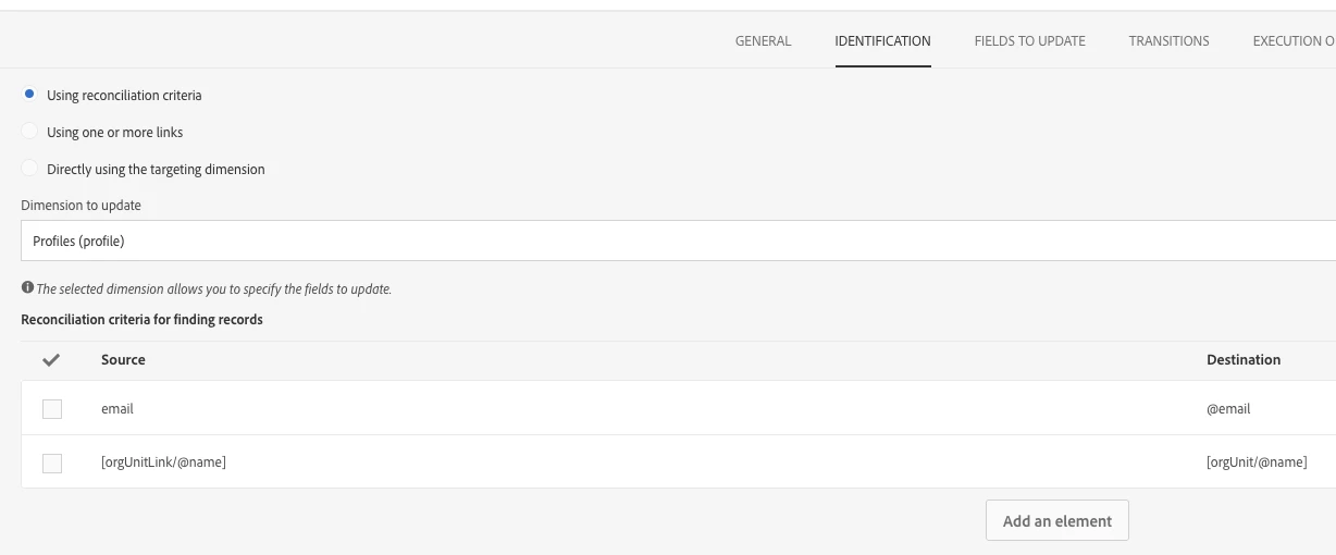

What criteria for reconciliation do you have on the Update task?
It's important to have both E-Mail + orgUnit there, else indeed it would just update anything existing.

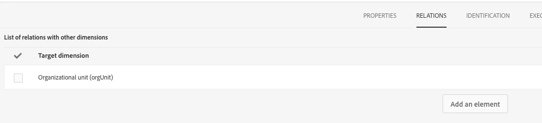

Posting the screenshots of an import workflow which would do exactly that:
  1. Load file content
  2. Reconciliation activity
  3. Updata Data activity
