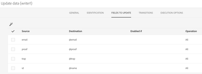

@asalgar ,
Can you make sure on update data activity "fields to update" section includes with mapping to update ID(@name) of the test profile. For example, on the csv file you can have id column along with other columns and that is mapped to ID (@name) on the test profile. Once you rerun the import you should be able to see test profiles.

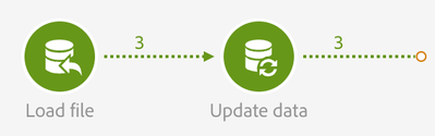

first i am loading a csv file using load data activity and using segmentation just to limit the count then in update data activity i have selected updating schema to "Test profile" and i have put the reconciliation on Email part from list the target mapping . i am not getting any error when workflow run and even in logs i can see that record is inserted and when i am trying to search the record . the record is nowhere to found.
@asalgar ,

@SatheeskannaK  thanks for the help now i am able to see the test profiles.
When we are uploading Test profiles using Upload activity, how do you enable Proof or Trap or both options for these profiles in bulk?
By default, they are disabled when I use a CSV file.
Any help is appreciated! Thank you!
Hi @sp57570507,
You can load the CSV file using Load file activity and create/update the test profiles either proof or trap or both using Update data activity in bulk.
