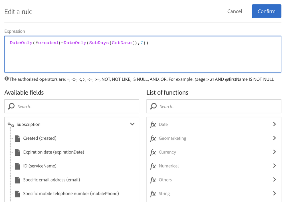

You can add another filtering criteria and use Advanced mode as follows:
For copy+paste purposes: DateOnly(@created)=DateOnly(SubDays(GetDate(),7))
Or you could use: DateOnly(@created)=DateOnly(DaysAgo(7)) and get the same result.
Note that the created date and GetDate() are both datetime fields, so I've had to use the DateOnly function.
My final incremental query looks like this:
