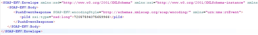

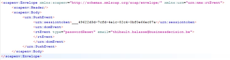

I then make a SoapRequest such as this :
I got a success answer :

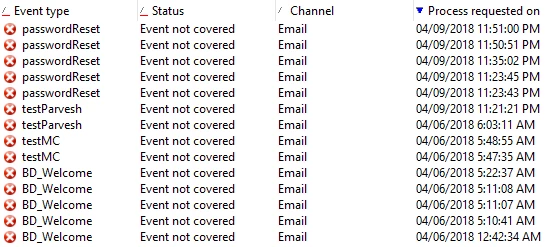

But still, when I check in the Adobe Campaign's event history, my events are not covered and the documentation doesn't help get through the problem.
I already check in the properties of the template to make sure the event name is correct and it's the case.
I also see that lots of people are facing this issue, do you have some answers for my problem ?

Make sure you are sending the soap request with the same operator, using which you have connected your execution server with the control server. i.e mc.
So Firstly take a session token from mc user -
Then use this token within your request.
I was using the different operator then I got the same issue. But after that I tried with mc then issue is resolved.
