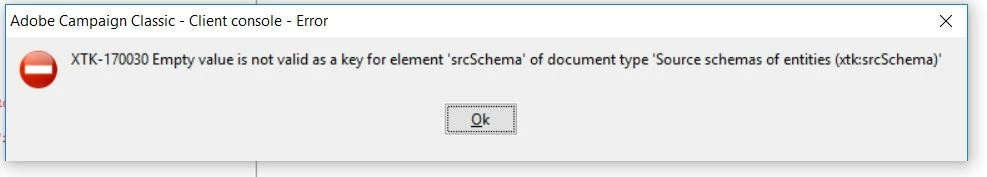

Dear All,
I am getting error while editing any schema or creating new schema in sandbox environment. I see one of our out of box schema(nms:seedMember) got corrupted and when I try to regenerate the same, getting xtk/170030 error so basically this error is not allowing me to do any modification in any of the schema. Kindly help me if you have encountered similar issue.
Attaching screenshot of error for your reference.

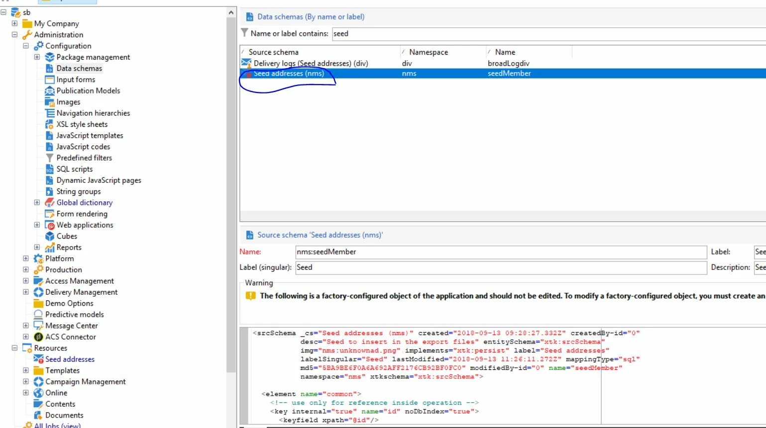

September 14, 2018
Hi Adhiyan,
Thanks for your response. I checked all schema with last modified field. I found some custom schema which showed date near to date when I saw issue. So cleaned up all but still issues remains same.
I have asked Adobe support to restore nms:seedMember once and see how it goes.
Let me know if you find any other approach to dig in and fix this. Thanks a lot.
