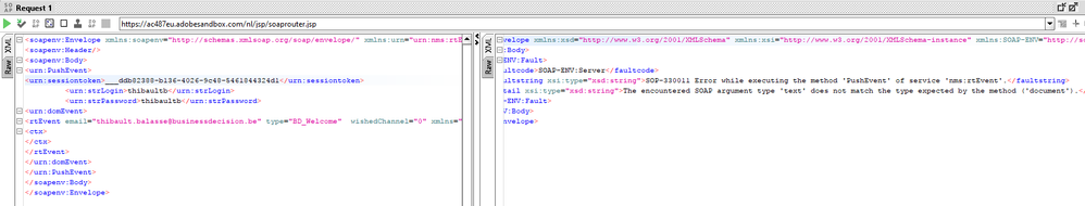

i'm working on a transactional messaging and I want to make some tests to get use to SoapUI (first time using it).
I first make a request to have a sessionToken that works fine with the ID and password of my instance of Adobe Campaign.
So I try now to link an event with a template I make on AC but I got a weird error when trying to link that.
I also check the documentation on how to link those 2 but I don't understand well how to use it.
I also try to make the rtEvent in only one lign but it failed also with the same error.
Those are the dataSchema and Javascript I make for this to work.
<rtEvent =" wishedChannel="0" email="thibault.balasse@businessdecision.be" type="BD_Welcome">
Do you have any idea on how to resolve the issue ?
Thank you for your help.
Thibault
UPDATE :
I got this type of error now :
Any ideas ?

Hi Thibault,
Could you please replace your existing rt event block with below one and test again to see if it helps
<rtEvent type="BD_Welcome" email="thibault.balasse@businessdecision.be" wishedChannel="0" >
</rtEvent>
Hi Thibault,
</rtEvent>
It seems to work thank you, it's weird because i try to do that way either and didn't work the first time.
