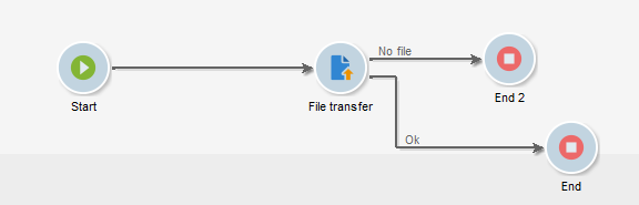

My requirement is to pick a file from SFTP location and then process it.
  • For that I am using, FILE TRANSFER Activity.
  • I had configured SFTP Details in External Accounts.
  • Below is my workflow:
  • Now when I run workflow, below error I am getting:
So ideally, if File not found in SFTP location, it should go to FILE NOT FOUND flow and end there, as per my workflow, instead it's breaking before step.
Please let me know, how to solve it?

From the error it seems, you have not assigned the proper directory+file name to file transfer activity. the error indicates that there is no file name so script considers folder name as file and fails.
you need to ensure that directory does exist and the existence of the file is optional.
The 'Server folder' contains the file path to the file on the sFTP that you wish to import, you will be provided the filename in the ticket. Simply paste in the filename provided after the folder directory (with extension) after '/custom-folder/file-name.csv'

Hi sonikad8559822,
Use File Collector if you are trying to download file from Adobe provided sFTP to Adobe Campaign. For any other external sFTP you should use File Transfer.
The error looks strange and definitely not the expected behavior.
Out of curiosity, I can see that the workflow says there is 1 file to transfer and then says File not found.

We are currently using External SFTP folder, so I will be using FILE TRANSFER Activity as suggested.
So, coming back to the above error screenshot, let me know how to resolve it.
