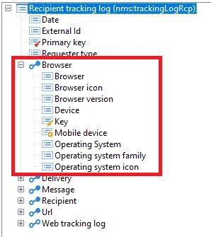

Does ACS have device information in the tracking logs (that can be seen in the UI / used for filtering etc).
It's easily accessible in campaign classic:
I can't see that the same is accessible in the ACS data model. I assume the data is tracked because there are reports that give device breakdowns. But can it be accessed when filtering tracking logs in workflows?
Can anyone confirm?

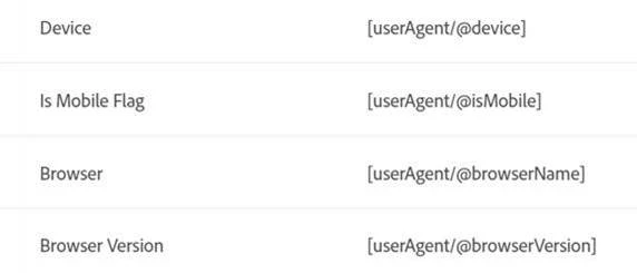

Device details can be added as 'Additional Data' to a workflow temp table, however it's not available directly as a link within the UI.
Here are examples of the available paths to these attributes.  You can create as additional data within a query activity against trackingLogRcp resource.  I'm only aware of these 4 fields.
[userAgent/@device]
[userAgent/@isMobile]
[userAgent/@browserName]
[userAgent/@browserVersion]
[userAgent/@device]
