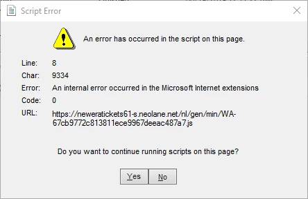

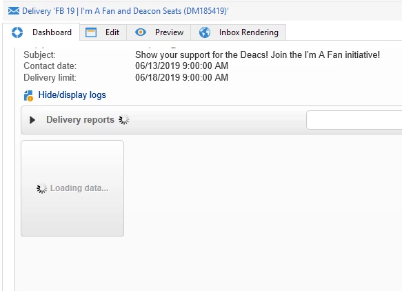

Does anyone know how to fix the issue depicted in the screenshots below? When attempting to view a delivery report, a Script Error pops up and the reports do not load - instead the "Loading data..." prompt continues to spin and never actually loads the reports.
This appears to be isolated to a single user, as I am able to access the reports using the same log-in credentials.
We've already attempted to clear the local cache and attempted to turn off script error notifications in Internet Explorer - but neither of those worked.
Any ideas?

Compare the permissions of the broken operator against a functioning operator (Administration/Operators > Access rights, Audit/Folder Rights).

Also - it's not a permissions issue, as I am logging in using the same operator credentials as they are and I am able to see the reports, but they are not.

/Hi Paciolan,
As you may know, Adobe Campaign Classic (ACC) uses internally Internet Explorer engine and its local settings on the PC user.
So, please  compare the Internet Explorer version of this user PC with your own IE configuration. It must be IE11 because Adobe Campaign doesn't support older version.
Then have a look in IE extensions coming into conflicts.
But it is much easier for doing the same to see the report in standard IE page, because you can then activate IE debugger tool.
So use the report url from your Adobe Campaign client report and copy/paste in standalone IE browser.
If the report is not anynymous but needs authentication, you will need to authenticate with the operator id first.
So ease the debug by publishing an anynomous one.

Thanks J-Serge,
I can confirm that the user is on IE11 - see screenshot below.
What kinds of extensions would be conflicting?

Hi Paciolan,
The Internet Explorer additional modules list (see IE burger menu) would help.
But you need some debug logs errors.
So please open the Internet Explorer developers tools (F12), and execute your report, it should show you in console or network or debugger tabs errors details. Sorry but it is technical, and could be so many reasons (conflict in Javascript, security blocks such as CORS, etc).
Moreover, execute the report in _debug mode in IE (or inside AC, in preview+debug mode) so you have a chance to understand what part is in conflict.
