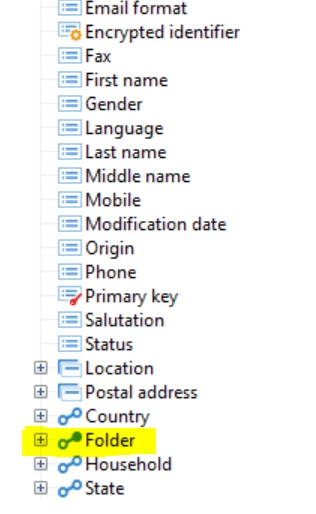

Whenever I fill the form the data is being captured and can be seen in my response logs. But when I tried to look into the folder where I configured the records to be stored the same is visible until I configure the list and try to check the data from the joining table.
Configuration:
Recipient table is connected with a custom table I created with the name of "XYZ" for example.
The recipient table has a foreign key of my table(XYZ) and shows connected in the structure just like the link that you can see for the folder in the below picture.
Issue:
I created a web form to store basic details i.e. First Name, Last Name, Email and One column(XYZ) table, which displays fine when configuring the fields of my form.

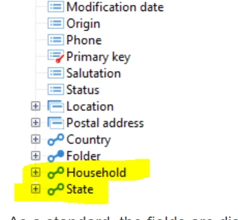

I added other fields in the form from the below list and mapped it to respective fields, which are highlighted below:
After the above process, I configured the list the data is showing fine for these.
The issue happens every time I try to add a field related to my table or the folder highlighted in the first snapshot and both the icons shows that they are related in the same way.

Best answer by Jonathon_wodnicki
The column you're adding to your view is causing the view to perform an inner join against a table that doesn't have data in it.
In your web app you need to write this data, alongside the captured recipient data.
-Jon
Jonathon_wodnicki
Jonathon_wodnickiCommunity AdvisorAccepted solution
March 3, 2020
-Jon
