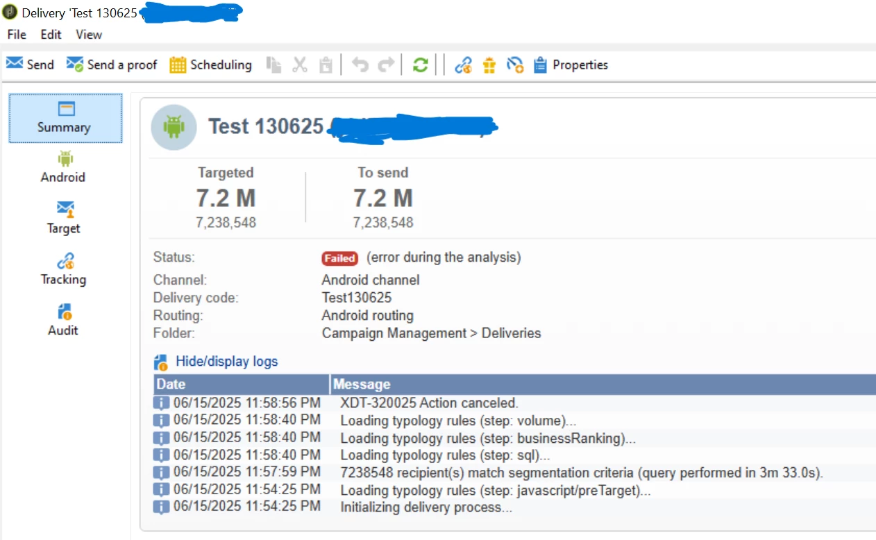

I can see that all records are being targeted in the audit logs.

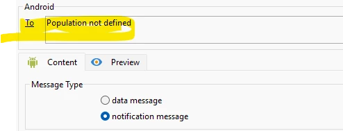

I was able to use the below script and when the delivery was created it was only created for one recipient.
Use the below script and also check one more important thing inside the template which you are using should not have anything inside the "To" Population it should be empty if this is empty then it will pull only the record which you are filtering see the screenshot below:
