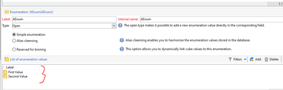

Create a OPEN type enumeration under /Administration/Platform/Enumerations/ and define it in your schema attribute.
Go to /Administration/Platform/Enumerations/ create new > Type: Open, and add the enumeration values eg, First_value, Second_value
Now in Data schema, call the above created open enumeration as userEnum

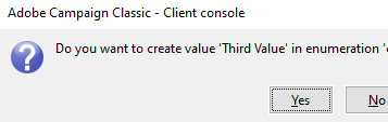

Now when a user click on  AEnumeration drop down, the user can see 'first value' and 'second value' in dropdown. But If the user enter 'third value', a pop-up will ask 'Do you want to create value 'Third Value' in enumeration 'Aenumeration', and on Clicking Yes, this new value will get stored in enumeration as well as in schema.
So when next user click on the same enumeration, he can see this new value as well in drop down
