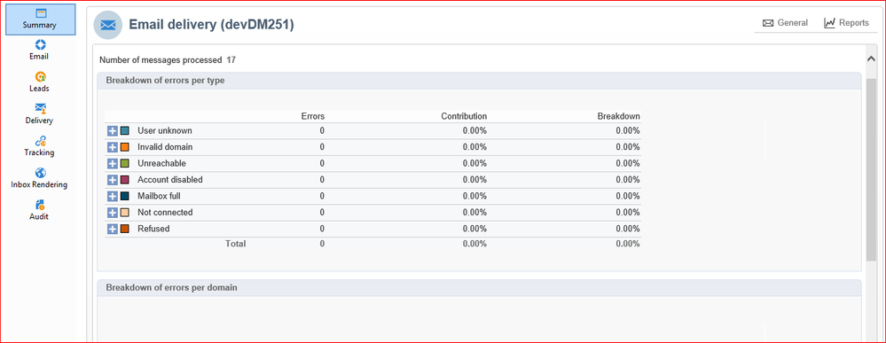

Under deployment wizard, I need to add values / parameters like deliveryID and deliveryCode. At the moment, am able to insert only one value at a time, but need to support multiple entries. Tried using comma, semi-colon, but nu luck. Could someone please help....

June 10, 2020
Hi @545806, Basically, I had two more questions, since I am integrating my MTA server with adobe, upon delivery I need to trace back the stats back to adobe for reporting. 1. With resp to failure reasons, like mail box full, not connected, refused, unreachable, what table should I refer to insert the values? Would it be directly 'nmsdeliverylogstats'? Any other tables I need to take care? Because the delivery success / failures I am inserting in 'nmsbroadlogrcp' table and they auto populate in 'nmsdeliverylogstats'. 2. Is it possible to import / create work-flow in a way to insert the entries in above 2-3 tables at the same time? Currently, my work-flow just inserts entries into 'nmsbroadlogrcp'. Any reference for example?
