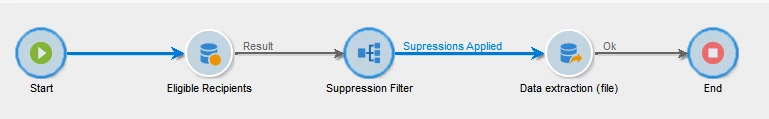

I'm attempting to create a handful of re-usable workflow blocks by using sub-workflow, but have come across a stumbling block when trying to pass a targeting dimension to the sub-workflow.
Main workflow:
Eligible Recipients query finds list of potential targets, then calls "Suppression Filter" workflow.
Suppression Sub-workflow:
Intention is for the Suppression Check to filter the inbound population based on re-usable suppression rules, save the excluded targets (in this test case, just to a text file) and then return to the main workflow with a reduced recipient list.
This is all very good in theory, but how do I go about making the inbound population schema available to the sub-workflow?
The documentation at Sub-workflow alludes to being able to pass a table and schema into the sub-workflow, but doesn't elaborate on how to refer to an input table and schema within the sub workflow. Is this even possible?

I think I've found a resolution, but here's the process that I went through, and my resolution - either for future reference for others in the same position, or for someone to correct me with a better way to achieve this.

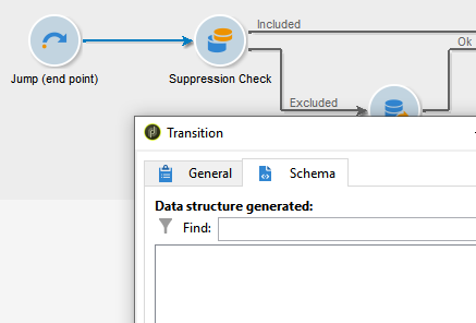

In the sub-workflow, the transition from the incoming jump point, does not have a table or a schema. This sort of makes sense, because the Jump in itself doesn't have a schema defined, and the sub-workflow can't know where it's going to be called from.

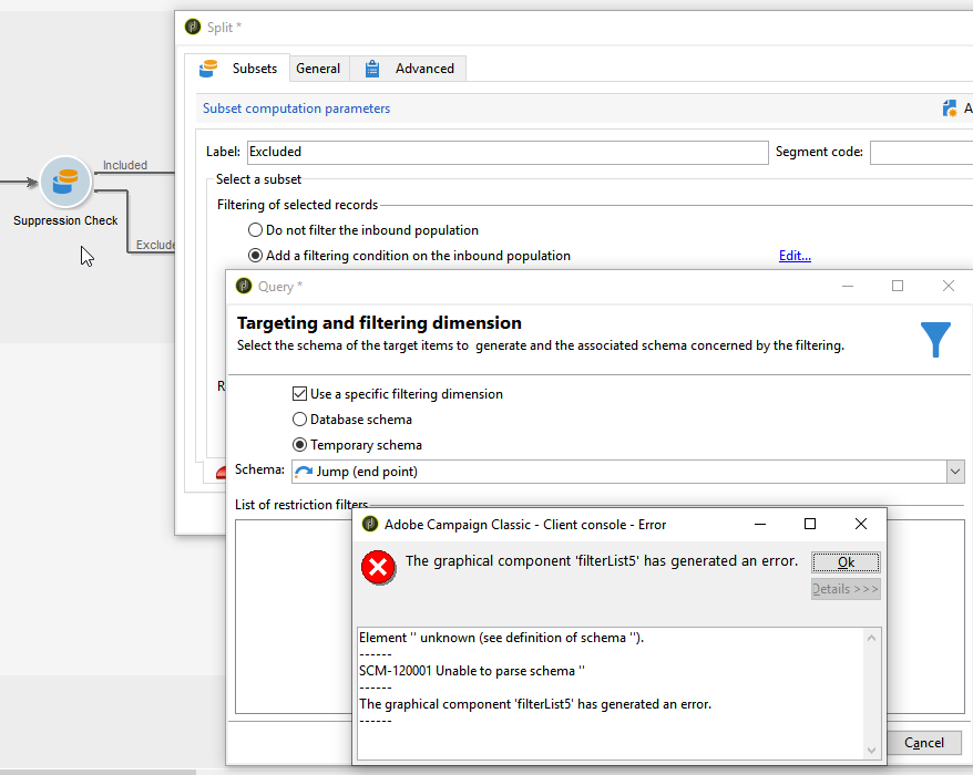

On the "Suppression Check" split, if I try to use the Temporary schema from the Jump, I get the following error, which again is not unexpected, because the Jump doesn't have a defined schema.

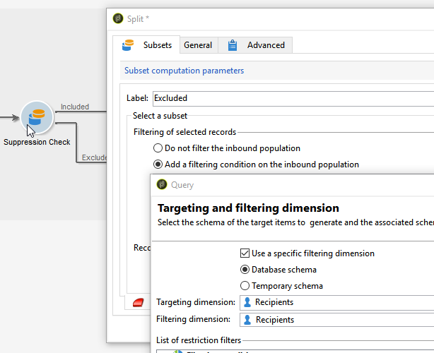

But I can use the nms recipient schema, and build my filtering query successfully:

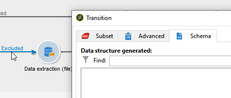

Even though the Suppression split is using Recipients for the Target and Filtering dimensions, the output transition still shows no schema:
And of course this then means that there is no schema defined for the Data extraction step:

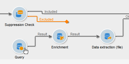

So what I've done is create a Query on the recipient table as well as an enrichment to get the linked attributes that I'm after. This results in me being presented with a list of available fields in my data extraction format:

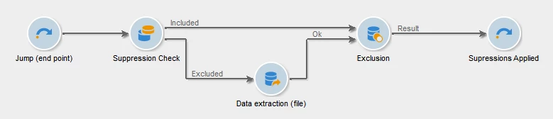

And finally, put the workflow back to how it should be, and disable the Query:
