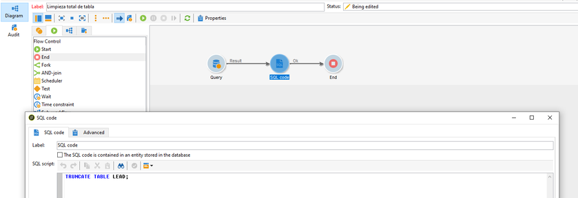

EDIT 1:
I think I can do it without the QUERY ACTIVITY? Only using the SQL Activity?
Like this:
Hi @god_prophet ,
In general it will be, NamespaceSchemaInternalName
Example, If your namespace is abc and internalName of schema is lead,
then table name is AbcLead
If you want to cross check and find the table name, go to your data schema > preview tab > and search for sqltable. you can find as below,
<element label="LEAD" name="lead" sqltable="AbcLead" ...>
TRUNCATE TABLE AbcLead;
5 Replies

Level 6
Actually, according to documentation TRUNCATE is better to delete all rows from a table. See:
The  TRUNCATE TABLE statement deletes all data from a table without scanning it. This is the reason why it is faster than the DELETE statement.
In addition, the TRUNCATE TABLE statement reclaims the storage right away so you do not have to perform a subsequent VACUMM operation, which is useful in the case of large tables.
That been said: In the SQL activity the table name is LEAD or abc:LEAD (taking into account the space name).

Level 6
Hi ParthaSarathy,
To get all records from LEAD schema, you just select the Targeting dimension and Filtering Dimension as LEAD, and click finish (without putting anything in Filtering conditions, right?
@god_prophet , Just click on filtering condition, and click finish. Run the query alone and check the result count of query's transition whether it is same count of schema's Data tab total count.
Or you can give a query condition as primary key is not empty.
