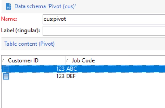

A) As an example I have created a schema name as cus:pivot

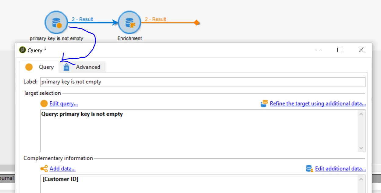

i) Query activity

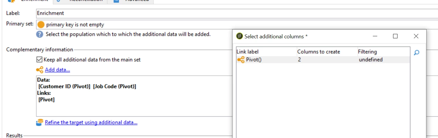

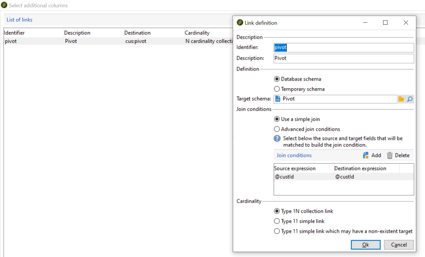

ii) Take the enrichment activity and make the self join with same table with the help of 1: N join while giving join condition
While adding the data please make sure to add column(No. of records to retrieve as per your convenience (By default it will be max 3 rows) ). So it will create multiple enrichment table based on your records to retrieve. In below example since I have two values so I have selected two
Add your data from these different temp enrichment table and result will be like below
B) Create a workflow like below
i) Query activity

I am not able to find "Select additional columns" from your snippet. Where to set these columns to create field?
kapilKochar
Level 6
May 19, 2022
Here you go
