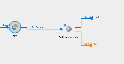

I am new to creating custom activities in workflow and seeking help here:
My use case is to create a custom activity that will just enable one of the transitions [either ok or not ok] based on the several conditions- this can be achieved with out of the box activities but I have to do it in a custom activity for final user simplification.
Currently based on the conditions I am able to enable one of the transitions but not able to create the outgoing temporary schema to pass to the next activity. Basically i need help in following, a sample code would be extremely helpful.
1. How to keep the incoming data as it is in the outgoing transition
2. How to filter the incoming data and create a new outgoing transition.

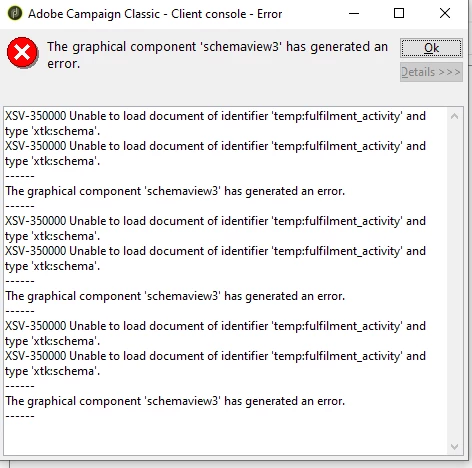

-- While opening the display target and check the output schema it is throwing below error and there is nothing under data tab[display the target > data]

While trying to share the js, I just went through it once and luckily got the error --
Mistake:
I was trying to create a table using - "select * from <previous table> and was trying to post this to outcome postEvent and the previous table name I was trying to fetch from xml body-- which was yielding the incorrect result, once I removed this code and directly used below mentioned code from @DavidKangni  response in https://experienceleaguecommunities.adobe.com/t5/adobe-campaign-classic-questions/outbound-transition-for-a-custom-activity/td-p/376520
 it worked 🙂
task.postEvent(task.transitionByName('transition'));
task.setCompleted();
return 0;
Thanks once again @costa_n11  @surabattulasr @DavidKangni  for all the help 😊
