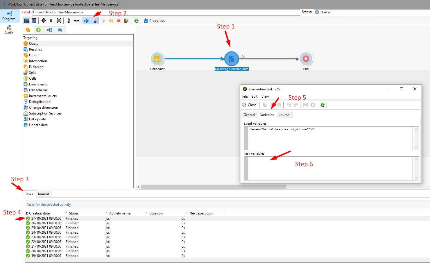

Best answer by _Shubham_Goyal
Hi @xliu
Try to follow the below steps in your workflow:
Step 1: Select the activity where the task variable is allocated.
Step 2: Click on the 'Display the task an logs' icon.
Step 3: Select 'Tasks' tab.
Step 4: Select the transition for which you need to see the task details.
Step 5: From Elementary task click on 'Variables'.
Step 6: Here under the 'Task Variables' field you will see the task variable data.
Adding screenshot of all the above steps.

_Shubham_Goyal
_Shubham_GoyalAdobe EmployeeAccepted solution
October 27, 2021
Hi @xliu
Br,
Shubham

_Shubham_Goyal
October 27, 2021
Hi @xliu
That's a good ask 🙂 but unfortunately the 'Task variables' are like local variables and can only be used by the current task. (task.vars.xyz)
Instance variables on the other hand are like global variables and are shared by all activities in a workflow.
The only way I can suggest is you can use logInfo(<task_variable_name>), and extract the value of the task variable in the output of the workflow logs.
