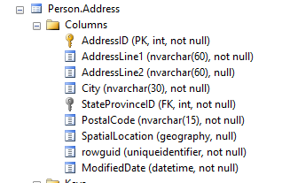

  3. For our test, we chose the table Person.Address. It has following columns. FDA table.png

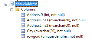

  4. Created a View on top of it and named it dbo.vAddress. Its structure looks like as shown here:FDA View.png
  5. As you can see we have picked a subset of columns for our purpose.
