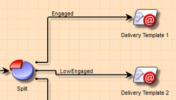

I'm working on an automated report and one of the fields I'm trying to pull is the label of the split subset the delivery is attached to. This is what I have right now in the Data Extraction activity:
In the picture below for example, I would be trying to get the values 'Engaged' and 'LowEngaged' for Delivery 1 and Delivery 2.
The expression above that I'm currently using just returns the label of first subset for every delivery. I've tested this on other campaigns with more than 2 subsets and they all just return the same label.
What I'm getting:
Delivery Label | Subset Label |
Delivery Template 1 | Engaged |
Delivery Template 2 | Engaged |
What I want to get:
Delivery Template 2 | LowEngaged |
Is there an expression I can use to achieve this or is this going to require a JS solution? Any help is appreciated.

The answer to both questions is to use js; get the workflow's data clob then parse it for transitions, i.e.:
for each (var extract in workflow.activities.extract) {
for each (var transition in extract.transitions.*) {
// make use of transition.@label, transition.@target
-Jon

Thanks Jon, apologies for bothering you but I'm not super familiar working with javascript in the context of pulling values from Campaign. Is there a resource I reference or some sample code? I tried figuring it out on my own and haven't had much luck. Thanks again for your help!
If your split is one time configuration, you can do JS variables in Advanced tab of split.
Js you can use:
vars.split1="Engaged"
vars.split2="Low Engaged"
And then you can use these variables in your delivery as: <%=vars.split1%>
Thanks.
