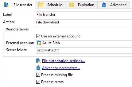

Is it possible to disable the suffix added to the downloaded files on the File transfer activity?
The file "attach1.pdf" downloaded like this:
The filename afterwards will be: attach1_20231003101346a.pdf.
I can remove the suffix via JS code, but I'm wondering if there's any way to remove this suffix.
Thanks in advance!
