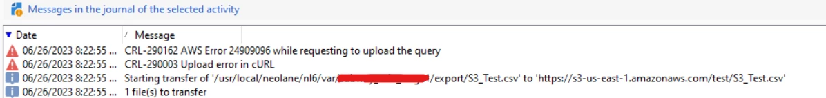

Best answer by amrita_kumaris4
Thanks all. The issue was resolved after adding the correct S3 bucket name in the external account config.

Hi @amrita_kumaris4 ,
feel the S3 bucket that you configured does not have permissions or your credentials to connect to the S3 might be expired.
Try to connect to S3 bucket using curl command bypassing region id, secret key, bucket name, etc, and test the connection, if it fails through curl then there is a permission issue at AWS and not at the campaign side.
akshaaga
July 2, 2023
@amrita_kumaris4 ,
This is very generic error.
Do you have detailed logs of the error?
Also, have you validated the configuration of S3 bucket yet?
amrita_kumaris4
amrita_kumaris4AuthorAccepted solution
July 3, 2023
