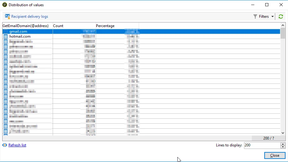

Hi @charella5661599 - You can do this is using a Distribution of values on the email domain from the broadLogRcp table.
Open up the broadLogRcp schema and click the data tab
Right-click the list and select Configure List
Add a new column and use the formula GetEmailDomain(@address)
Click the Distribution of values button and you should get a table showing you the email domains, Count and Percentage of each domain in the broadlog.
This will contain all statuses (Sent, Failed, etc) so play with the filtering to get the results you want. It also only contains the last 180 days or however long you have your broadLog retention period set to
