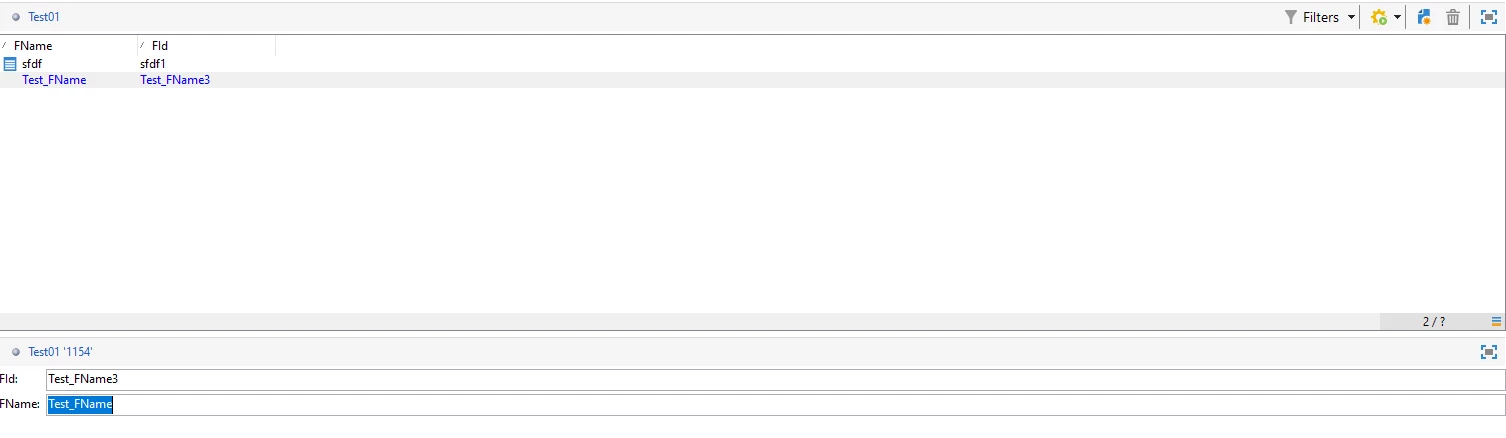

Hello @dipendu_g ,
As I understood, you want, when someone enter the "fname" value in the input form then Unique "fId" will generate automatically when someone save the input form.
For this, I did the following test.
Schema: There you need to add following two fields and need to define a method:
<srcSchema _cs="Test01 (cus)" createdBy-id="0" entitySchema="xtk:srcSchema" img="xtk:schema.png" label="Test01" mappingType="sql" md5="5CA41EE99322B61D35A2210A9D7956BB" modifiedBy-id="0" name="test01" namespace="cus" xtkschema="xtk:srcSchema"> <element autopk="true" label="Test01" name="test01"> <attribute label="FName" name="fname" type="string"/> <attribute label="FId" name="fId" type="string"/> </element> <methods> <method library="cus:test01.js" name="genId" static="true"> <parameters> <param desc="fname" inout="in" name="fname" type="string"/> <param desc="fId" inout="out" name="fId" type="string"/> </parameters> </method> </methods> </srcSchema>

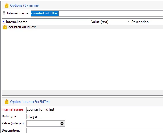

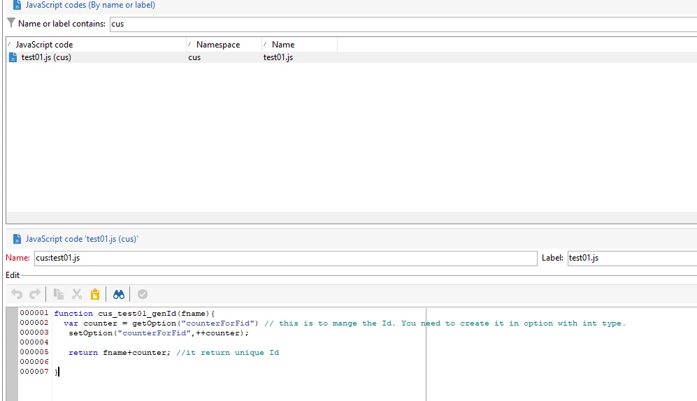

JavaScript  Library: You need to create a .js file under JavaScript code folder in admin.
function cus_test01_genId(fname){ var counter = getOption("counterForFid") // this is to mange the Id. You need to create it in option with int type. setOption("counterForFid",++counter); return fname+counter; //it return unique Id }
Option: To mange  a unique fId, you need counter. If someone can enter same fName the it will keep fid unique.
Input form:  There when someone enter the  value for "fname" field, it will pass to the function and it will return the unique fId based on fName. Note: There fname is passed to function via soap call and output of function is inserter to fId via xpathOut parameter.FId filed is read only, because this is id.
<form _cs="test01 (cus)" entitySchema="xtk:form" img="xtk:form.png" label="test01" modifiedBy-id="3524" name="test01" namespace="cus" xtkschema="xtk:form"> <input readOnly="true" xpath="@fId"/> <input xpath="@fname"/> <leave> <soapCall name="genId" service="cus:test01"> <param exprIn="@fname" type="string"/> <param type="string" xpathOut="@fId"/> </soapCall> </leave> </form>
Navigation hierarch: I believe you already created it. Just sharing if needed.
<navtree _cs="test01 (cus)" entitySchema="xtk:navtree" img="nl:folders.png" label="test01" md5="AE43085ADF6D10668FDC881DCD8DDB64" modifiedBy-id="3524" name="test01" namespace="cus" xtkschema="xtk:navtree"> <model name="root"> <model label="Administration" name="admin"> <model label="Test01" name="cusTest01"> <nodeModel img="nms:folder.png" label="Test01" name="nmsFolder"> <view name="listdet" schema="cus:test01" type="listdet"> <columns> <node xpath="@fname"/> <node xpath="@fId"/> </columns> </view> </nodeModel> </model> </model> </model> </navtree>
Final test: Enter Fname and save the value. Fid will be generated.
I hope it will help you.
Parvesh
