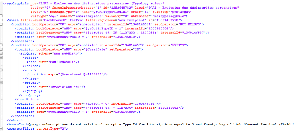

So I tryed to transform the condition balisis in :
<condition setOperator="IN" expr="@CreatDate">
  <subQuery schema="nms:subHisto">
     <select>
       <node expr="Max([@CreatDate])" />
     </select>
     <where>
       <condition expr="[@service-id]=1127236"/>
     </where>
<groupBy>
<node expr="[@recipient-id]"/>
</groupBy>
   </subQuery>
</condition>
But It didn't worked.
Can someone help me to have the right format ?
Thanks by advance !

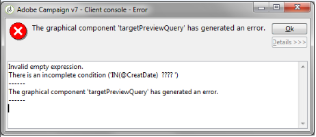

Hello guys,
I did the modification and still not working
This is the graphic result I have in my typology rule request window ;
But when i'm doing a data preview:
I don't get how to construct my subRequest without the SQLData !
Thanks by advance,

Alexandre,
La colonne SQL tsCreated correspond à l'élément @date dans le schéma nms:histo, et non pas @CreatDate.
Cdt
JS
<where filterName="backGroundFilterFrm" filteringSchema="nms:recipient" id="13601463290">
    <condition boolOperator="OR" expr="subscription" internalId="1360146501" setOperator="NOT EXISTS">
      <condition boolOperator="AND" expr="@yrOptinTypeID = 2" internalId="1360146504"/>
      <condition boolOperator="AND" expr="[@service-id] IN (1127232 , 1127236)" internalId="1360146507"/>
      <condition expr="@yrConsentTypeID = 2" internalId="1360146510"/>
    </condition>
    <condition boolOperator="OR" expr="subHisto" internalId="1360146573" setOperator="EXISTS">
<condition boolOperator="AND" setOperator = "IN"  expr="@created" internalId="1360146628">
<select>
   <node expr="Max([@date])" />
</select>
<where>
</where>
<groupBy>
</groupBy>
  </subQuery>
</condition>
      <condition boolOperator="AND" expr="@action = 0" internalId="1360146796"/>
      <condition boolOperator="AND" expr="[@service-id]=1127236" internalId="1360146883"/>
      <condition expr="@yrConsentTypeID = 1" internalId="1360146898"/>
    </condition>
</where>
it should work.

Hello guys,
Thanks by advance,
